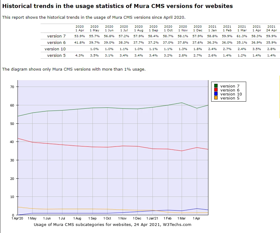

    As the language CFML evolves, so too do applications built on it, like Mura. Mura would certainly have adapted to exploit the new functionalities in CFML.
    Consider this error a warning shot. I would bet 99:1 that there will be others. That is, if you import the (application code + Mura code) as-is from ColdFusion 11 to ColdFusion 2018.
    For example, have a look at the fields within the init() of /mura/bean/ioc.cfc in Mura 7.1. They are declared in private, variables scope. This contrasts with the cfproperty declaration of your Mura version.
    My suggestion is therefore that you should consider your upgrade a two-pronged project:
    1. Upgrade ColdFusion from version 11 to version 2018 (preferably 2021)
    2. Upgrade Mura to the latest version compatible with ColdFusion 2018 (or ColdFusion 2021). As you can see in the picture below, the statistics suggest the latest version of Mura 7.x (picture reference: https://w3techs.com/technologies/history_details/cm-muracms )

    Charlie Arehart
    Apr 23, 2021 11:40 PM UTC
    That dump of details shows the code is at line 26 of C:\inetpub\clients\WEBSITE2021\requirements\mura\bean\ioc.cfc.
    That's in the Mura cms framework, which your app uses. That's called ultimately from line 51 of your C:\inetpub\clients\WEBSITE2021\config\appcfc\onApplicationStart_method.cfm.
    I suspect you are using an older version of mura, and a later one fixed the problem. Check out https://www.murasoftware.com/ for help on that.
    /Charlie (troubleshooter, carehart. org)
