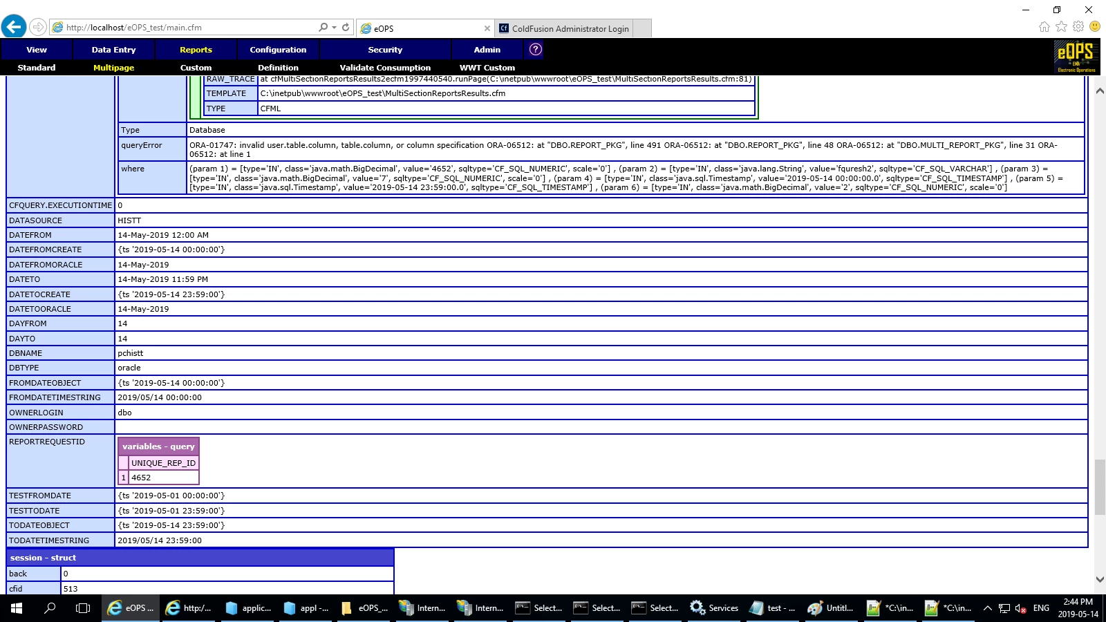

    Hi friends,
        I have used the code as suggested by BKBK but with in a CF stored procedure, here is the code I have used and the error I get now is slightly different from the previous ones.
    <cftry>
    <cfset fromDateObject=parsedateTime(datefrom)>
    <cfset toDateObject=parsedateTime(dateto)>
    <cfset fromDateTimeString=dateFormat(fromDateObject, "yyyy/mm/dd") & " " & timeFormat(fromDateObject, "HH:nn:ss")>
    <cfset toDateTimeString=dateFormat(toDateObject, "yyyy/mm/dd") & " " & timeFormat(toDateObject, "HH:nn:ss")>
      <cfstoredproc procedure="dbo.multi_report_pkg.run_multi_report" datasource="#datasource#" username="#Session.UserName#" password="#Session.password#">
        <cfprocparam  value="#Session.multi_rep_id#">
        <cfprocparam  value="#Session.UserName#">
        <cfprocparam  value="#multi_report_def_id#">
        <cfprocparam cfsqltype="CF_SQL_TIMESTAMP" value="#parsedateTime(fromDateTimeString)#">
        <cfprocparam cfsqltype="CF_SQL_TIMESTAMP" value="#parsedateTime(toDateTimeString)#">
        <cfprocparam  value="#period#">
      </cfstoredproc>
    <cfcatch type="any">
      <cfdump var="#cfcatch#" label="cfcatch" >
      <cfdump var="#variables#" label="variables">
       <cfdump var="#session#" label="session">
    </cfcatch>
    </cftry>
    We're getting there. This error says there is a problem with a column name.
    Check whether there is a column name having an illegal character. Did you perhaps use a column name that is a reserved word in Oracle?
