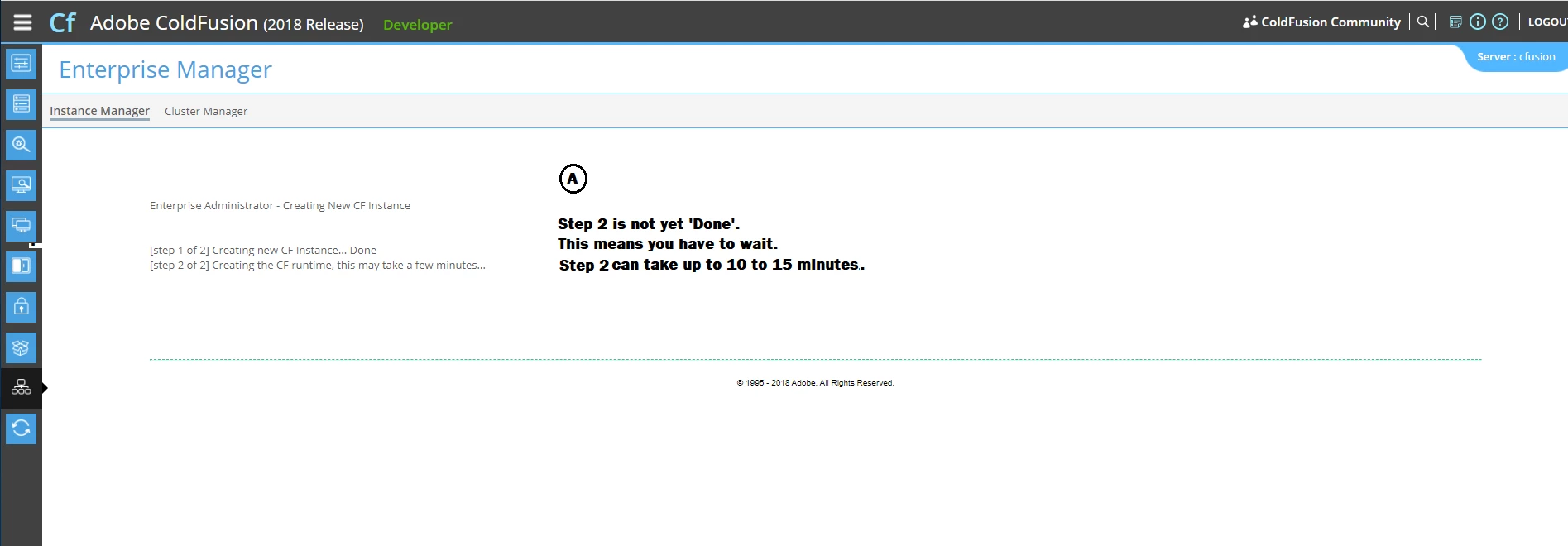

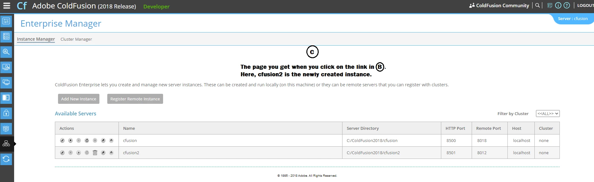

    BKBK
    Aug 13, 2021 12:02 PM UTC
    quote
    I'm trying to create a new instance using the CF2018 instance manager. I can see that the new instance folder is getting created and files were copied but the webpage never comes back to say that the process was completed. It happens whether I choose to create the windows service or not. I don't see any errors in the CF or Windows logs. I'm not sure what is supposed to happen once the folder is created and populated.
    By @porkslap
    To answer your question, the following happens in the Instance Manager page when ColdFusion finishes creating a new instance:
    • 'Done' appears next to Step 2;
    • A link appears, with link-text "Return to Enterprise Manager".
    When you click on the link, CFAdmin will refresh the Instance Manager page, displaying all the instances, including the one you've just created.
    See attached images.
    From your description, I can think of only one possibility. You did not wait long enough for ColdFusion to completely create the new instance.
