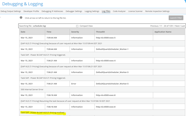

    Thank you for taking a look at this.  I am running update 10.  I was mistaken initial post in that scheduler.log is showing signs of the problem.
    The scheduled tasks were all newly-created and then re-created.  It doesn't matter which paused task I try to manually trigger via the scheduler in CF administrator.  The first each day will result in a misfire.
    Here is the scheduler screen:
    And then the subsequent log entries:
    The scheduler indicates the manual trigger as a misfire and then we see the 7:06:21AM entry as an error 500.  I can repeat this each day like clockwork.
