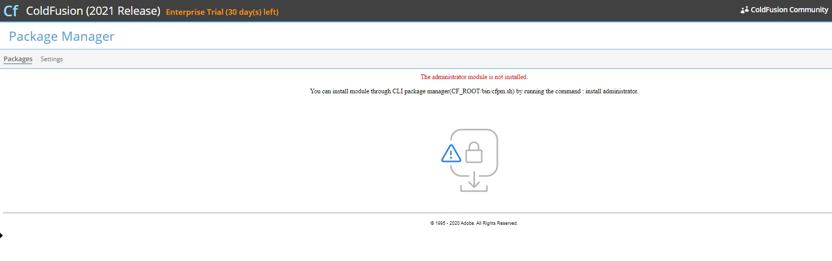

I have Coldfusion running on Linux 8 behind a firewall.
From CF admin, I was able to update from 2 to 3 and then to update 4.
I'm having issues upgrading from update 4 to any other version.
I selected update 5 download and install.
I clicked OK and then it shows
 Unable to proceed beyong this point.

I restarted / rebooted, still the same ie.,
The administrator module is not installed.
You can install module through CLI package manager(CF_ROOT/bin/cfpm.sh) by running the command : install administrator.

Admin server starts but cannot Admin server via browser and get
