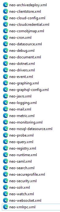

3. Runtime configuration (XML)
  • Open the directory ColdFusion2021/cfusion/lib and sort the contents by Name.
    Ensure that each of the following system files is present:
  • Sort the files in ColdFusion2021/cfusion/lib by Type, then by Date Modified. Pay attention to the most recently modified neo-***.xml files.
    Examine each in an XML editor to ensure that its contents are reasonable and not corrupt.
  • Were there any errors or discrepancies? Note them down and bring them to the forum for discussion.
