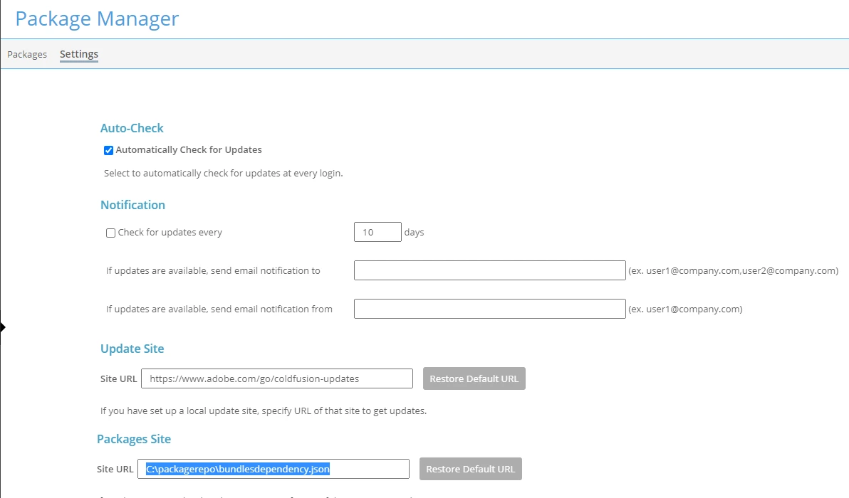

    Dec 11, 2021 4:36 PM UTC
    Thanks Ja..It is good if somebody can provide some guidelines.. Nothing seems to be working for me.. I tried
    Step 1: Uninstall the updates, make sure the CF admin page is accessible.
    Step 2: Download the update repo from below link
    https://cfdownload.adobe.com/pub/adobe/coldfusion/2021/packages/hotfix-packages-cf2021-002-328618.zip
    Step 3: Copy the package to server, unzip it to a directory ( example: C:\packagerepo)
    Step 4:  Change the location of repository in ColdFusion 2021 admin page. Navigating to Package Manager > Settings and change the package site to point to "bundlesdependency.json" file in C:\packagerepo as shown in below screenshot and click on submit changes.
    Step 5: CF2021 update 2 installer can be found in unzipped folder - \hotfix-packages-cf2021-002-328618\bundles\updateinstallers location. Copy the hotfix-002-328618.jar to C:\ColdFusion2021\jre\bin folder.
    Step 6. Stop all the ColdFusion services. Open command prompt as admin, navigate to C:\ColdFusion2021\jre\bin folder and run the below command:
    <cf_root>/jre/bin/java.exe -jar hotfix-002-328618.jar
     After following the above procedure my administrator modules went off...
