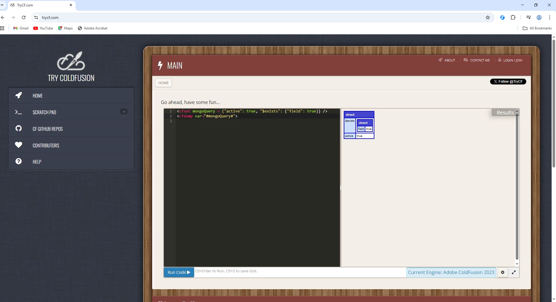

    Hi @Junaid32092262a1i8 , As far as I know, there was no change in the handling of boolean type between ColdFusion 2021 and ColdFusion 2023. You can confirm this yourself.
    Do the following test, independently of your application, to help you isolate the root cause of your error:
    1.  Go to https://trycf.com ;
    2.   Select ColdFusion 2023 as engine and run the code
       You will see that the code runs as expected. That is, without any errors.
