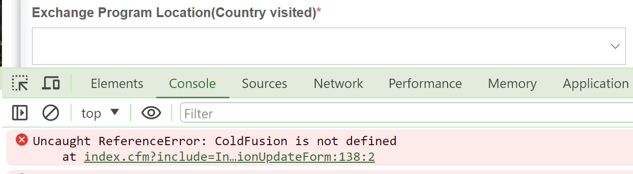

We have recently upgraded from 2021 to 2023, and we are facing an issue in cfforms, binding is not working on cfselect. we have checked the cfscript directory location and scripts and everything is alligned. It will be great if someone can provide a solution please.

Errors generated in console:
<!-- Errors generated in console  -->
form.cfm:123 Uncaught ReferenceError: ColdFusion is not defined
    at form.cfm:123:2
