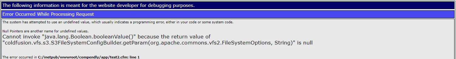

We are migrating from CF2018 to CF2023 and many of our S3 calls have broken. In CF2018 we are using delete object calls like this:
fileDelete("s3://#s3accessKeyId#:#s3awsSecretKey#@#s3Bucket#/#object#")
When we try the same code on CF2023 we get this error:
Cannot invoke "java.lang.Boolean.booleanValue()" because the return value of "coldfusion.vfs.s3.S3FileSystemConfigBuilder.getParam(org.apache.commons.vfs2.FileSystemOptions, String)" is null null
Any help figuring out how to delete a file in S3 would be greatly appreciated.

    You may be presuming there has been some change in how cf would perform that operation, but the real problem may be that something has caused all those variables to differ in value (between how your app runs in cf2018 and 2023).
    Since you have both available to you ("are migrating"), do this as a sanity check: wrap a cfoutput/writeOutput around those vars:
    Do the results differ at all (for the same request) on the two instances?
    /Charlie (troubleshooter, carehart. org)

    I've done as suggested and output all the variables in CF2018 and CF2023. The strings are identical in both version. The code works in CF2018 but does not work in CF2023. CF documentation on how to access AWS S3 is very limited. In fact there is no example of how to delete an object at all. (There is an example of how to delete an entire bucket, but that is not what I am trying to do.) I just need to delete an object.
    Can anyone provide some sample code to simply delete an object in S3 using CF2023? The fileDelete() method does not seem to work in CF2023 sp3.
