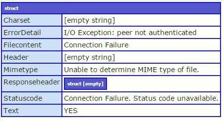

I'm stuck guys. I don't know what do do. We've been having this problem for awhile when dealing with a payment gateway that we get a "Connection Failure". Now, it is not all the time. It is intermittent. Maybe 1 in 25 or so. That rules out certificates right? My thoughts are that if it were a certificate then no requests would actually complete. So I set up a test page that does a test call to the payment gateway, the payment gateway we are using is eProcessing Networks' Authorize.Net emulator. Now, I got an error the first time I ran it.
Amazingly I was able to reproduce it. Just once. Then it started working again like nothing ever happened. I really need help guys. I will provide more information if you need.

<cfdump var="#cfhttp#">

It does not necessarily rule out the certificate. In my experience, it is still most likely the certificate. Most larger payment gateways have multiple host serving the web service requests. Often times, not all the servers have the same certificate installed. I think when a cluster of servers are used in this configuration all the servers need the same certificate installed so I would consider this a configuration failure on the gateway side -- but this is skirting my expertise with SSL certificates. Back to my experience, every "I/O Exception: Peer not authenticated" issue I have come across has ended up being a certificate issue of some sort.
Actually while finishing up the above typing, I did think of another issue: The cypher suites. Older less secure cypher suites are being removed from servers to keep up with PCI requirements. CF9 (actually the Java version the CF9 relies on) cannot properly negotiate a secure session when all the weak cyphers are removed. While we might have been able to fight through making CF9 work, we upgraded to CF11 and everything worked perfectly. Hope this helps. Good luck.

We've had that happen too. Very frustrating.  It's a ColdFusion bug.  Add getAsBinary="never" to the HTTP tag.
James Moberg
Feb 5, 2016 3:09 PM UTC
If you any other connection issues with ColdFusion 9, you may want to consider switching to CFX_HTTP5.  It's faster and supports more features. ColdFusion 9 uses Java 1.7 and won't work with some newer SSL certificates (even though Java documentation indicates that it is possible.)
