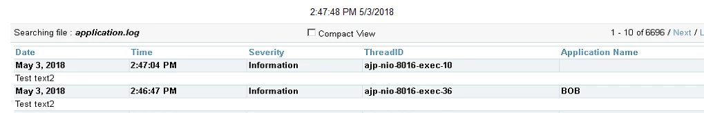

    Nope, that’s not a current but in CF2016 update 6. I am attaching here a screenshot of how a log line for an app with name="" (or indeed one with no name at all) is in fact appearing in the CF Admin log files display for the application log (you said application.cfm log, but I will assume that was a finger fumble).
    You may want to check what update you’re on (6 is the latest, from last month). Perhaps this was an issue fixed along the way in some update.
    In the screenshot below, you'll see I tracked a cflog first with an app name (of "bob") and then one where I did name=""). After the image, I address your CF10 comment also.
