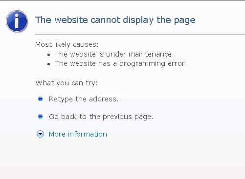

In February 2013 I patched ColdFusion 9 with the hotfix APSB13-03, both on my production and development servers.  Everything went perfect on the development server but production had some issues, I can't recall anymore exactly what happened but I was able to get it to the point that everything worked; meaning that all our cf webpages are served up correctly both inside and outside our organization.  The only standing problem is that the ColdFusion Administrator will not load.  Going to http://localhost/CFIDE/administrator/index.cfm returns

If you're getting 500 error which means the hotfix was not applied properly and you missed something. Only option which I think is to roll back the update and you can copy all the backup folders and the re-apply the hotfix. If you search forums you will lot of users had same issue and that is because they missed something while applying the hotfix.
