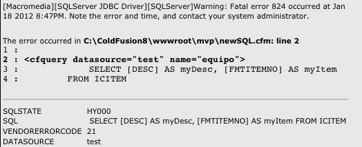

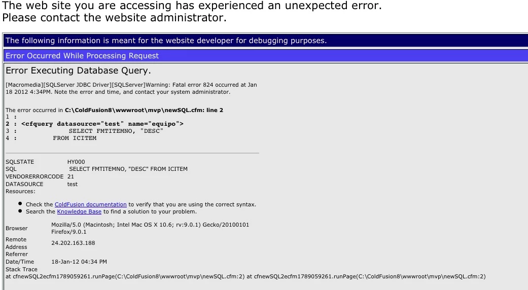

However, when I try to get a different column called FMTITEMNO, which exists, i get an error using this query:
<cfquery datasource="test" name="equipo">
        SELECT FMTITEMNO, "DESC"
        FROM ICITEM
</cfquery>
Error:

Correct answer Reed_Powell-ttnmOb
That means that there is a problem with your database.  If you google "SQL Server Error 824" you'll see a number of references that will give you steps for determining what the problem is.  If you have someone who acts as the DBA for your MS SQL server, you're going to need their involvement.
-reed
January 19, 2012
In MS SQL, if you need to reference a column with an illegal name, you need to put the column name in square brackets and the alias the name so that you can reference it in the query resultset.For example, I have a table that is created via an import from an Excel spreadsheet, and the spreadsheet happens to have a leading space in the column name as well as in the middle of the column name:
<cfquery name="PropertyList" datasource="Feeds">
  SELECT Resort, [ Resort Name] AS resort_name, [ country code] AS country_code
  FROM xxx
</cfquery>
I then reference those columns in the CF code as Feeds.resort_name and Feeds.country_code
-reed
Dani Szwarc
January 19, 2012
Thank you Reed, but I still get the same error when trying to get both results. However, they work individually.
I'm scratching my head with this.
Reed_Powell-ttnmObCorrect answer
January 19, 2012
-reed
