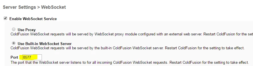

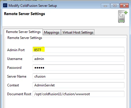

I was able to resolve this by changing the Admin Port value in the Remote Server Settings screen to the value of Web Socket port in server settings.  The Admin port default to 8989 which is not correct in my case.
Server settings in  //<server>/CFIDE/Administrator

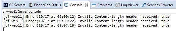

I still get an error when trying to stop or start the server remotely from CF Builder.
However, the server does do what is expected.
