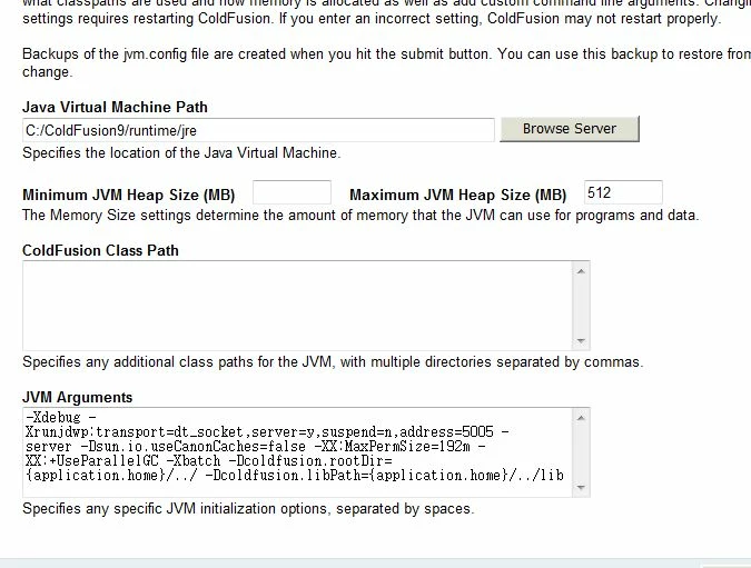

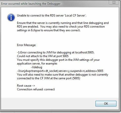

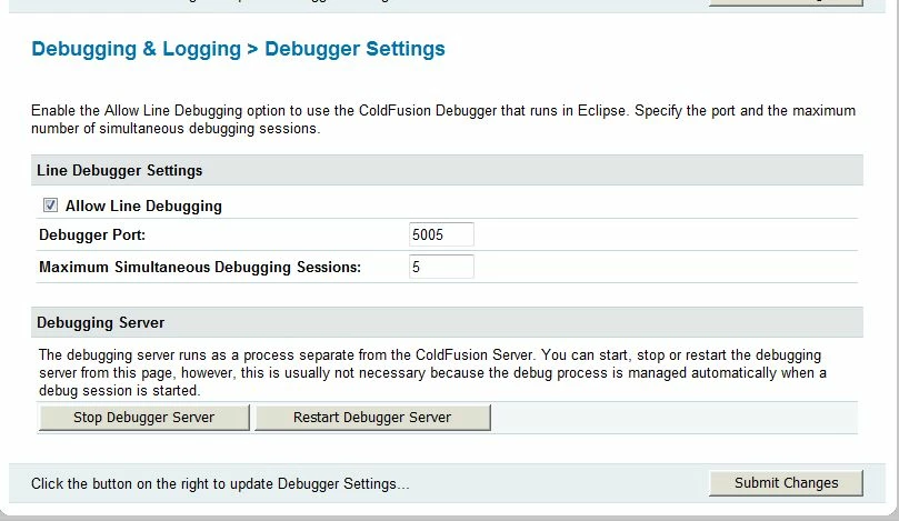

I can't get my Debugger to work.  I'm using a locol development CF and a remote MYSql Database. RDS is enabled and I have check to see the the port 5005 is not conflicting.  When I launch the debugger I get an error. Any help greatly appreciated.  Been messing with this for hours.
Settings and errors below.

Go to Debugger Setting in Administrator and enable "Allow Line Debugging " and Debugger port which you have defined in JVM Config.
Now Click on Start Debugger Server.
Hope it will help...
