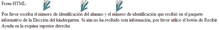

ColdFusion Changing Spanish Characters
For some reason ColdFusion seems to be changing some spanish characters. I've narrowed it down to ColdFusion (or maybe IIS 6 scripting handler) because the text comes out fine on a plain .html file but simply changing it to .cfm causes the characters to come out incorrect. Any help would be great! Thanks

First, I would ensure that you are using the proper page encoding.  You can utilize headers or override it with the <cfprocessingdirective>.  I currently use utf-8.
Secondly, how are you generating the characters?  Are you using their HTML entity codes?
For example, to output: This is an A character with a grave: À
You need to be generating:  <p>This is an A character with a grave: &agrave;</p>
You can optionally use the entity code, like: <p>This is an A character with a grave: &##224;</p>  (Note the double # to ensure ColdFusion does not assume you wanted a variable/BIF there.

I thought it was all UTF-8 as the response headers in Chrome said so. However, apparently ColdFusion was not processing as UTF-8 because the <cfprocessingdirective pageencoding="utf-8" /> tag did fix the issue. I had to place the tag in every page as it doesn't seem to work just in Application.cfc
There was a secondary issue that I didn't explain here. I store the translated text in .json files. So when <cffile /> was reading the translations it wasn't using UTF-8 either. Adding the charset="utf-8" quickly solved that issue as well.
