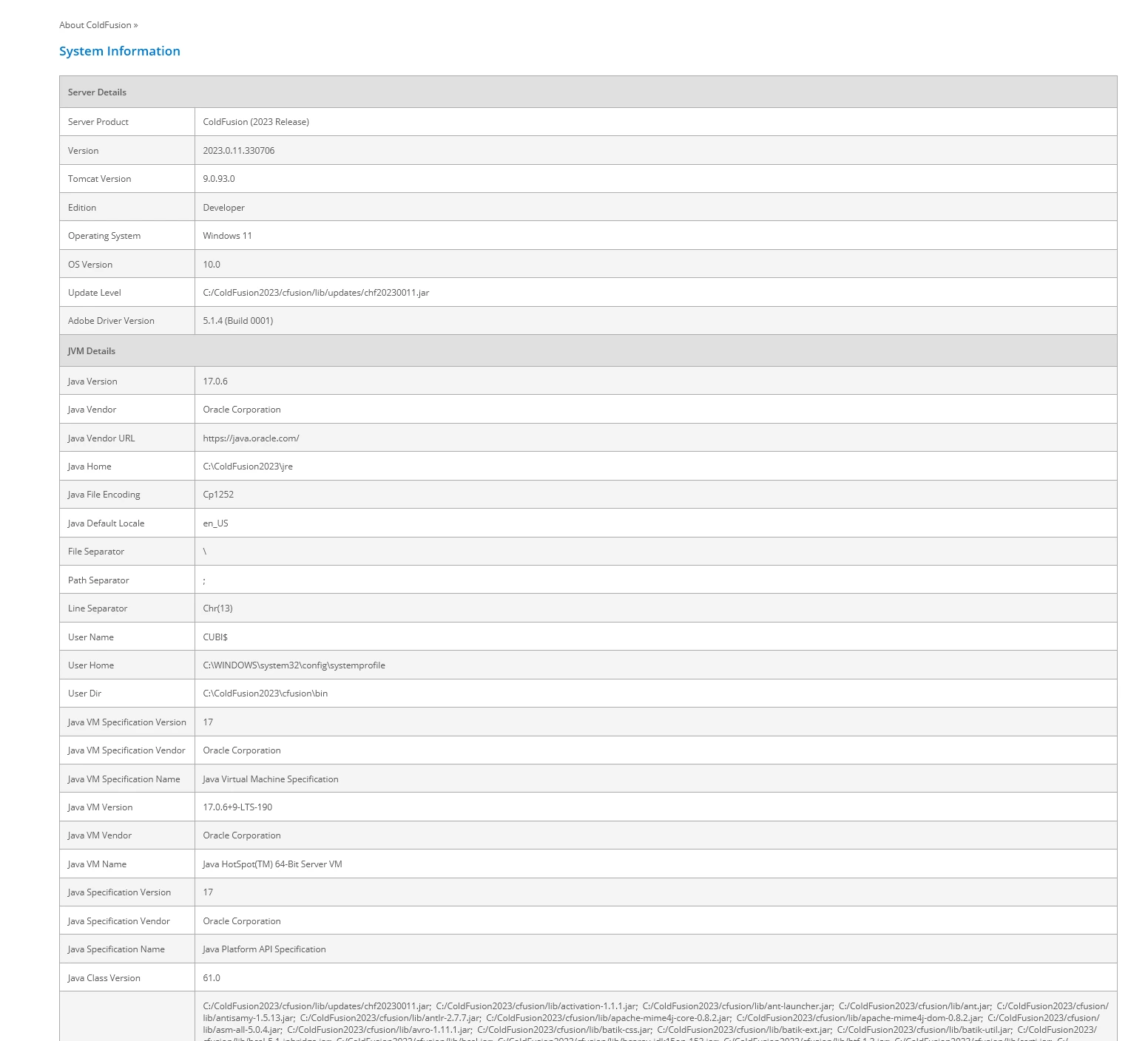

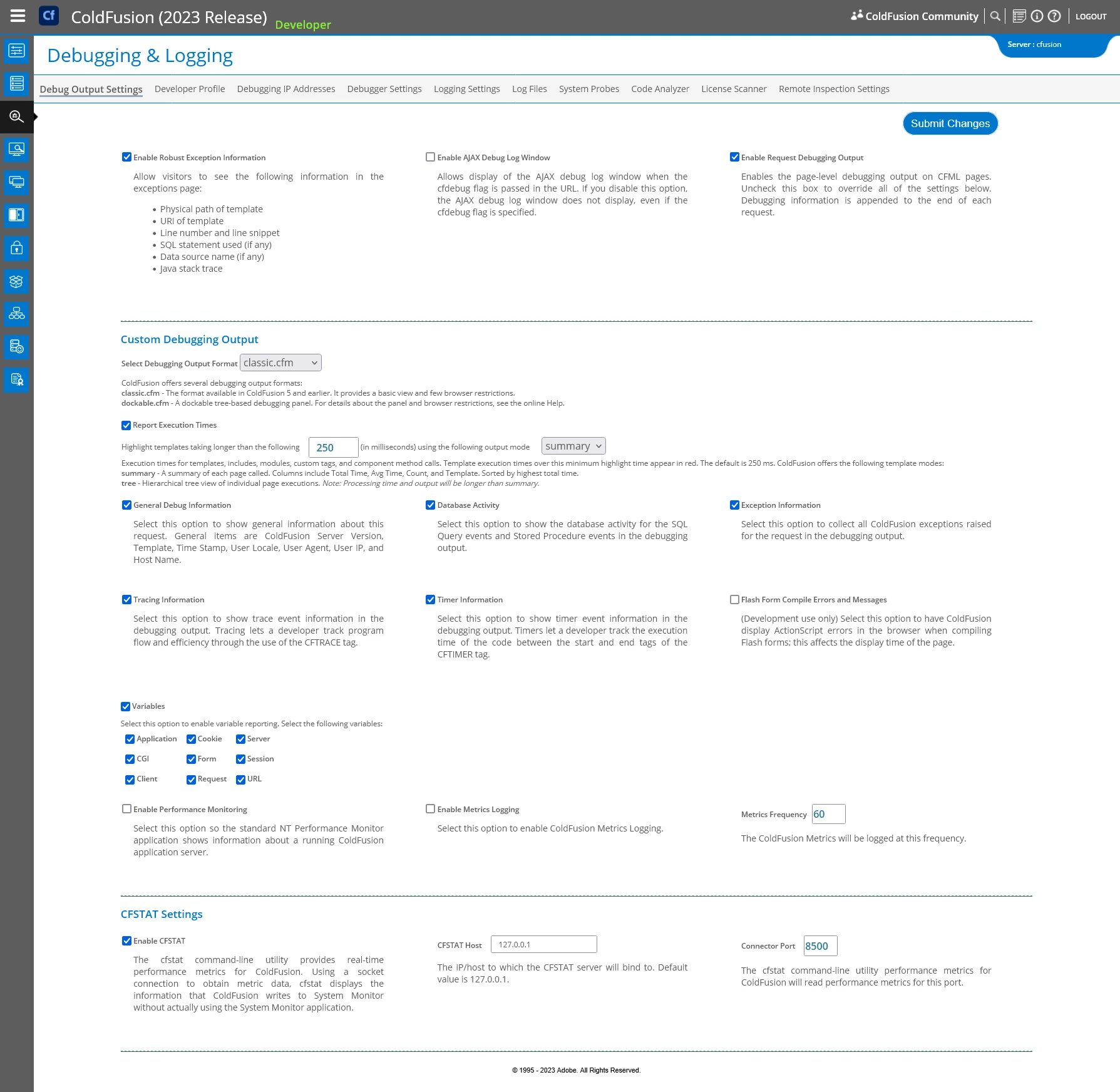

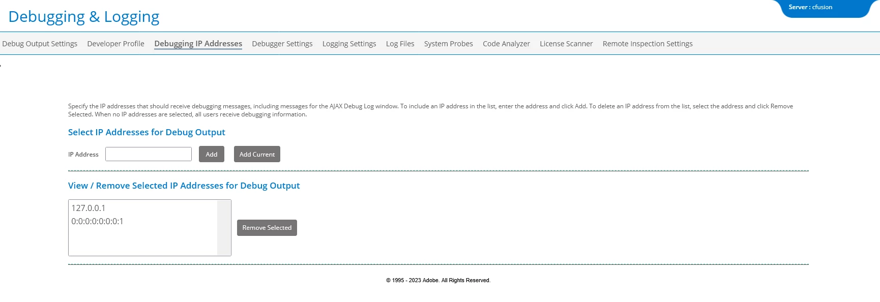

I've been developing for a long time without it working. But it did work on my old machine.
Now I really really need it to work.
CF 2023, up to date.
Windows 11 is up to date.

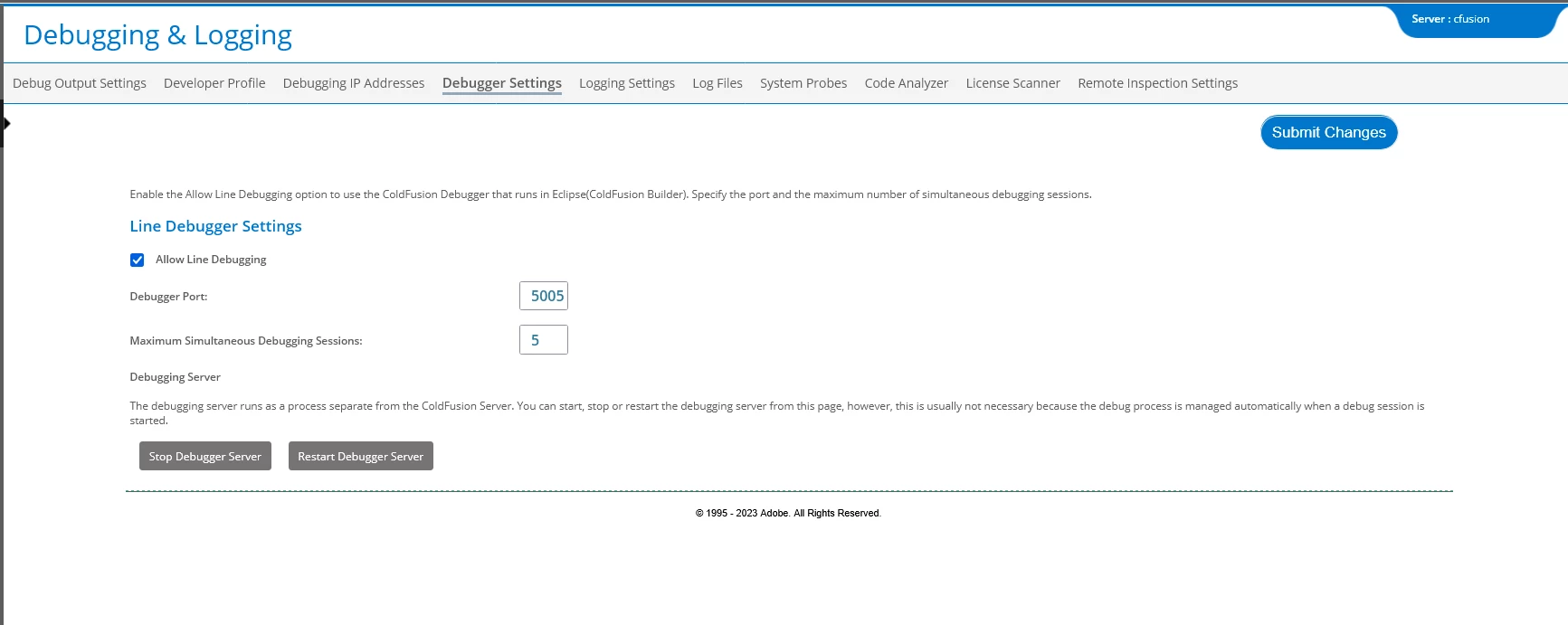

Debugging Port is set to 5005
I even opened this port in Windows 11 to make sure that wasn't the issue.
