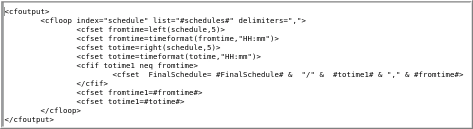

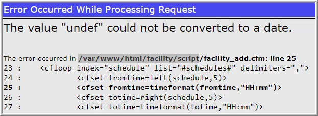

We have a small internal deployment of Coldfusion MX 7. The server is dead so I am build a new one. I am facing and error when running the site. The original programmer has left and I am not good at this. Can someone help me on this? Thank you.

    A couple of suggestions:
    1) Output the value of that fromtime variable (using cfoutput or cfdump), putting it before the bold line. It seems it's not going to look like the timeFormat function expects.
    If you have trouble doing that (seeing output before it errors in the loop), then instead output the schedules variable before the loop. It may not look at all like the code is expecting. It may even be empty.
    Once you know the state of things, then you need to determine how it got that way, given the flow of processing.
