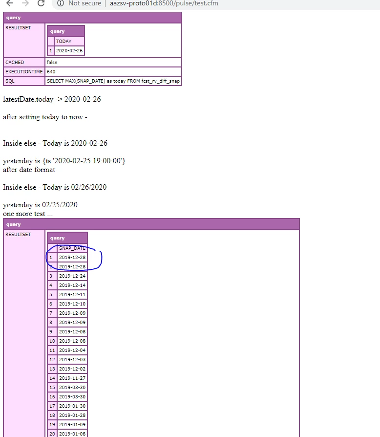

ColdFusion is showing one previous date when I fetch it from the database
when I am fetching the date from the database it's showing one date before.
for example -
if date in the database is - 2020-02-26
then when i fetch to my coldfusion using select date from db it shows - 2020-02-25.
I checked for the now() which is showing correct.- showing accurate now date and time.
issue is only when i am fetching it from the database.

yashpalm70379645
Feb 28, 2020 6:40 AM UTC
Thanks man, for the reply !
I checked it using dump also - It is showing incorrect in cfdump too...
on the above I have dump the query,
below is the actual result from database.
2019-12-29
2019-12-29
2019-12-25
2019-12-15
2019-12-12
2019-12-11
2019-12-10
2019-12-10
2019-12-09
2019-12-09
2019-12-05
2019-12-04
2019-12-03
2019-11-28
2019-03-31
2019-03-31
2019-01-31
2019-01-29
2019-01-10
2019-01-09
strange thing is same is working fine on my local CF 2018.
Issue is only on azure instances.. I checked the timestamp also which is equal for both azure instance and mysql database.
yashpalm70379645
Feb 27, 2020 11:05 AM UTC
It is happening with the azure VM only which resides on EAST US regoin. I checked the timestamp and both db server and VM belongs to the same timezone.
when I check the same on my local it is working fine but failing only on azure instance.
