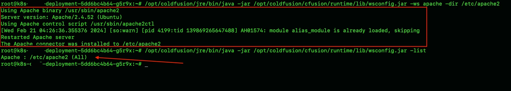

I have set up ColdFusion in a pod of my Kubernetes cluster. I have configured all settings (services, ingress, etc.), and everything is working fine. However, I'm unable to connect ColdFusion to the Apache web server through wsconfig.
I've successfully done the same setup in a Docker container, but I encounter errors only in the Kubernetes cluster. The process of connecting wsconfig to Apache seems to proceed without errors, and when I list the wsconfig connected server, Apache is displayed.

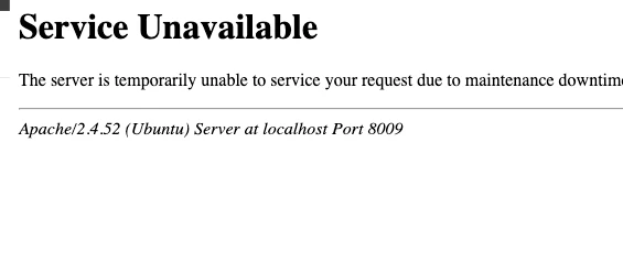

When I access the server (Apache), it's working, and I can reach it. However, when I try to run a CFM file, it gives a 503 error.

    Ok. I think you'll find this is a problem in how the localhost reference in workers.properties is being resolved (such as to ::1  in your k8s setup vs 127.0.0.1 in your docker setup).
    If so, the solution is to change cf's server.xml file to recognize that as an allowed address by which the AJP connector can be reached. This was  discussed in a forum thread (about such a 503 connector error) where I offered details in comments here:
    https://community.adobe.com/t5/coldfusion-discussions/tomcat-503-service-unavailable-error/td-p/11817160#M187746
    And FWIW, it was introduced in a Tomcat security change introduced into cf  in March 20202, as I blogged (again with more detail) here:
    https://www.carehart.org/blog/2020/3/20/how_and_why_sites_may_break_after_Mar_2020_CF_updates
    Let us know if you get going.
    One last thing: as you may know, you don't NEED to implement tomcat WITHIN the cf container. You COULD set it up as it's own, and then use cf's "distributed" configuration of the connector (discussed in cf docs and elsewhere as if cf and the web server were on a separate machines). But hopefully the above will get you going, without taking that step.
