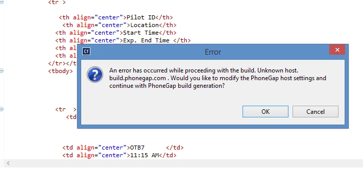

Dear Cf guys,
I'm just trying to build a mobile app in CF 11 & builder 3  ... i've setup phone gap host settings & trying to generate app files but its getting me phone gap UNKNOWN HOST error     see below image  .....  please help me to solve this
Best Regards ,
Bibin V

You say you are able to log in to your phonegap account from the browser. That's a start. Then enter or re-enter the same e-mail and password that you use here into the PhoneGap settings page in Coldfusion Builder. Don't forget to press on the Apply button, before OK.

This could happen if the phonegap build service is down.  When you get this error try and go to build.phonegap.com in a browser and see if it responds.
Bibin-_V-Author
Jul 7, 2014 8:06 AM UTC
Thank you for quick support  , i can able to login my phonegap account from browser  Also i've tried with new phonegap account that i created now but not helped
