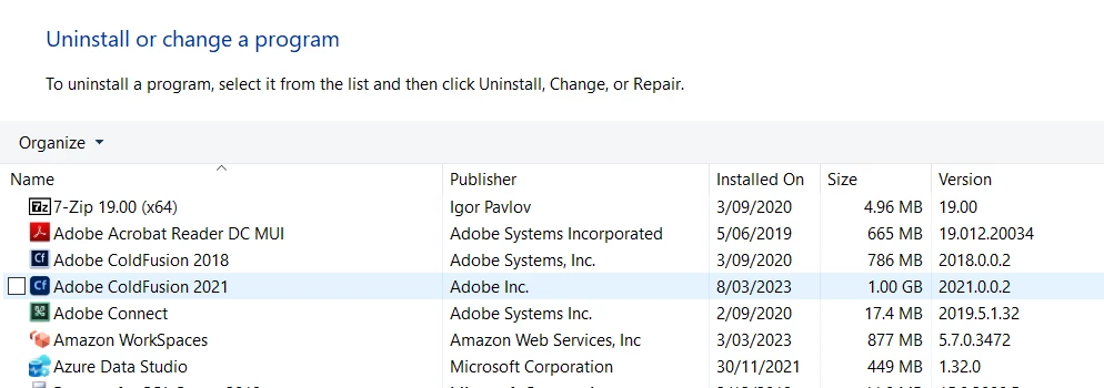

I installed ColdFusion Version 2021. Updated to version 6. But our IT using Rapid7 still seeing as 2021.0.0.0 build and flagging security risk. How do I update version of installed programs
    Mar 30, 2023 9:43 PM UTC
    Rapid is probably looking at the installed version. For the general release that was 2021.0.0 for refreshed installer 2021.0.2.
