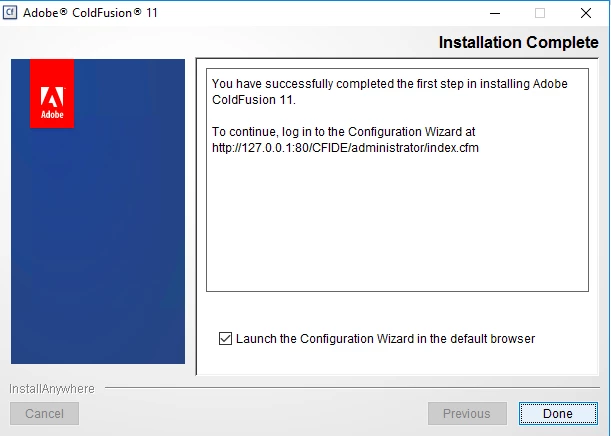

Configuration Wizard never launch to the site
So after I've finish installing Coldfusion 11 Enterprise version, the "Launch the Configuration Wizard in the default browser." checkbox was checked. I click the Done button and the default browser was launched to http://localhost/CFIDE/Administrator/index.cfm  but here's the error page.
So, how do I go into the Coldfusion configuration wizard? This is the last step of my installation and it failed.

    Charlie Arehart
    Oct 12, 2017 8:05 PM UTC
    Do you notice that the screenshot says to do 127.0.0.1 but used localhost? Did you try that? And I assume that you are trying this from a browser on the machine where CF was installed, right? If not, then you need to use the IP address or domain name for that server, reaching some site defined in the web server on that machine.
    And is the box you're on running Windows and IIS? If so, you can go into IIS, find the site, find the CFIDE folder and its administrator folder, and you could right-click on that and choose manage folder>browse, which will open the browser on the server and should load the CF admin.
    Let us know how any of this goes.

    2CharlieAuthorCorrect answer
    Oct 17, 2017 3:48 PM UTC
    Thanks for the response. I contacted Adobe tech support and got it figured out. Turned out, I need to turn off my proxy in Internet Explorer.
