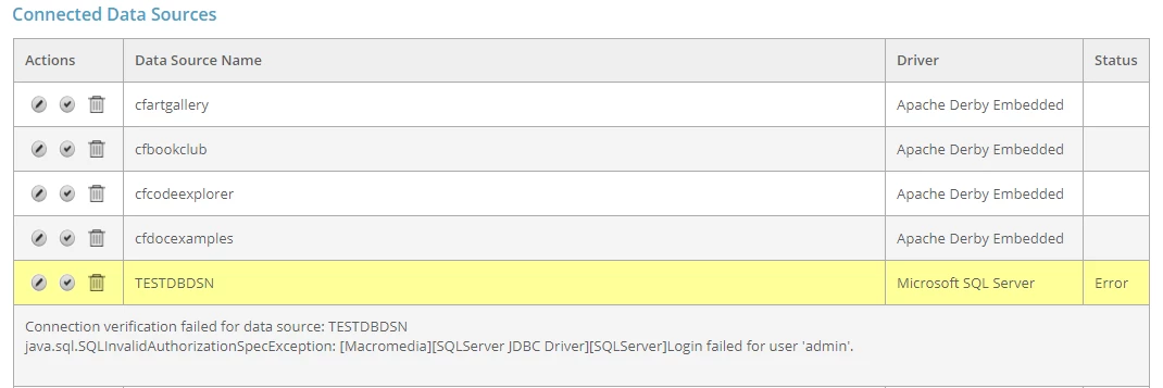

Connection verification failed for data source
Environment Details:
ColdFusion 2021 Release
Microsoft SQLServer 2019
Microsoft SQLServer Management Studio Version 18.8
Error Message:
"Connection verification failed for data source: TESTDBDSN
java.sql.SQLInvalidAuthorizationSpecException: [Macromedia][SQLServer JDBC Driver][SQLServer]Login failed for user 'admin'."
when i add new datasource in coldfusion administration page by selecting Microsoft SQL Server Driver,Im getting above error message.
I have entered only Server Name as "DAGEOP", the CF administrator by defalt adding user name as "admin" and some hidden password.
Kindly let me know what mistake i have done and how to solve this error.

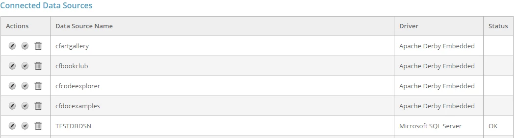

Thanks again Dave,
As you said, I have created SQL Login and  It is  working now.
After 20 years gap, I have successfully execute my CFQuery Statement 🙂
