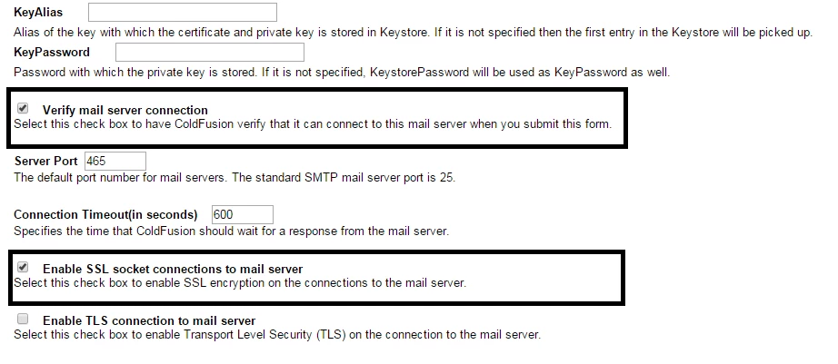

    we have enable in mail server setting SSL socket connections to mail server, here you can see our setup after check verify mail  server connections, but issue carry on.

    Thanks for the clarification José Antonio Chao,
    The setting seems fine for mail sending process.
    However, Have you ever tried sending a mail from a cfm page with cfmail tag? Does it work perfectly?
