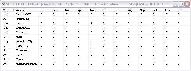

I have fixed the query, and it now runs with no errors (see image & code below), but it is not listing any records for April, only the May records show?
SELECT DATE_FORMAT(cfmDate, '%M') AS 'Month', tblColloNode.NodeDesc,
       SUM(CASE WHEN DATE_FORMAT(cfmDate, '%d') = 1 THEN 1 ELSE 0 END) AS 'Jan',
       SUM(CASE WHEN DATE_FORMAT(cfmDate, '%d') = 2 THEN 1 ELSE 0 END) AS 'Feb',
       SUM(CASE WHEN DATE_FORMAT(cfmDate, '%d') = 3 THEN 1 ELSE 0 END) AS 'Mar',
       SUM(CASE WHEN DATE_FORMAT(cfmDate, '%d') = 4 THEN 1 ELSE 0 END) AS 'Apr',
       SUM(CASE WHEN DATE_FORMAT(cfmDate, '%d') = 5 THEN 1 ELSE 0 END) AS 'May',
       SUM(CASE WHEN DATE_FORMAT(cfmDate, '%d') = 6 THEN 1 ELSE 0 END) AS 'Jun',
       SUM(CASE WHEN DATE_FORMAT(cfmDate, '%d') = 7 THEN 1 ELSE 0 END) AS 'Jul',
       SUM(CASE WHEN DATE_FORMAT(cfmDate, '%d') = 8 THEN 1 ELSE 0 END) AS 'Aug',
       SUM(CASE WHEN DATE_FORMAT(cfmDate, '%d') = 9 THEN 1 ELSE 0 END) AS 'Sep',
       SUM(CASE WHEN DATE_FORMAT(cfmDate, '%d') = 10 THEN 1 ELSE 0 END) AS 'Oct',
       SUM(CASE WHEN DATE_FORMAT(cfmDate, '%d') = 11 THEN 1 ELSE 0 END) AS 'Nov',
       SUM(CASE WHEN DATE_FORMAT(cfmDate, '%d') = 12 THEN 1 ELSE 0 END) AS 'Dec'
FROM      tblStatus RIGHT OUTER JOIN tblCalixFilterMaint ON tblStatus.statusID =
tblCalixFilterMaint.cfmStatus LEFT OUTER JOIN tblColloNode ON tblColloNode.NodeID
= tblCalixFilterMaint.cfmCollo
GROUP BY tblColloNode.NodeDesc, DATE_FORMAT(cfmDate, '%M')
ORDER BY tblColloNode.NodeID, DATE_FORMAT(cfmDate, '%M')
May 10, 2010
It is probably because you are using different date formats. The article groups/orders by "mm/dd/yy", and the CASE statement filters by month number. Whereas you are using month ('%M') and day '%d' only. Is that intentional?
