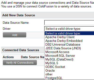

I'm changing from CF9 to CF11 and I have already purchased licenses. But I can not find the option to set the informix driver that is not in the list of available drivers !!!

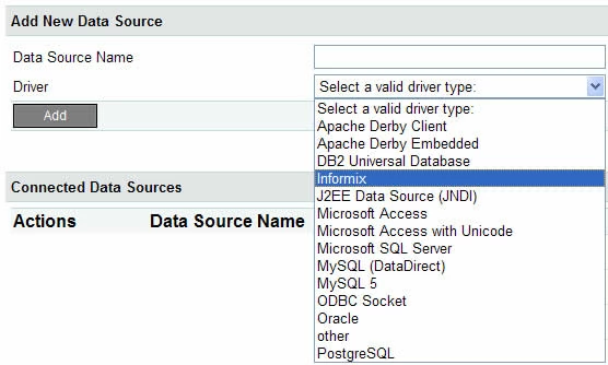

    The reason for which i asked is that "informix" jdbc drivers should be included in the select box of drivers in datasource page of Cold Fusion Administrator as it was for CF9.
    In CF 11 documentation it looks supported but it isn't.
