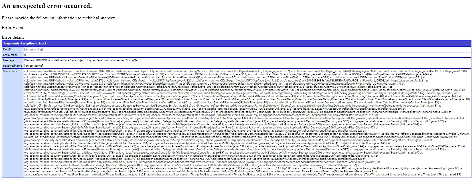

    When I ran the same code again, I got an error identical to yours:
    BKBK

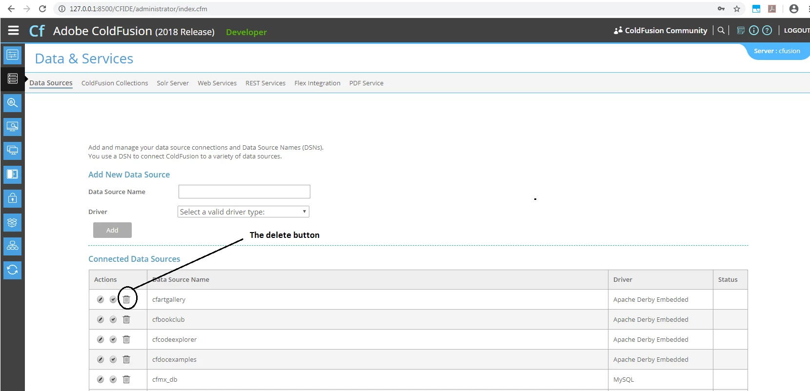

    ecarey :"What is the suggested way to delete unwanted datasources at setup?"
    Without code certainly!
    Open the ColdFusion Administrator.
    Go to the datasources page.
    Click on the delete button of the datasource concerned.
    And you're done in under 10 seconds. 🙂
