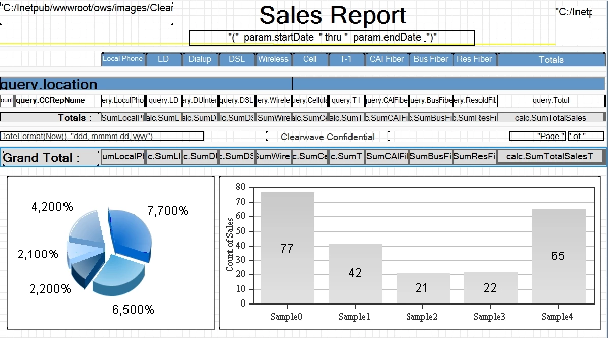

Stevie, In the WHERE statement of your ColdFusion Report Builder SQL, add DATE_FORMAT to the fields like this:
(Note that I'm only referencing a single database field called srCompDate)
WHERE DATE_FORMAT(tblSalesReport_history.srCompDate, '%m/%d/%Y') BETWEEN '#param.startDate#' AND '#param.endDate#'
Now you can use these parameters on your report like this:
"(" & param.startDate & " thru " & param.endDate & ")"
