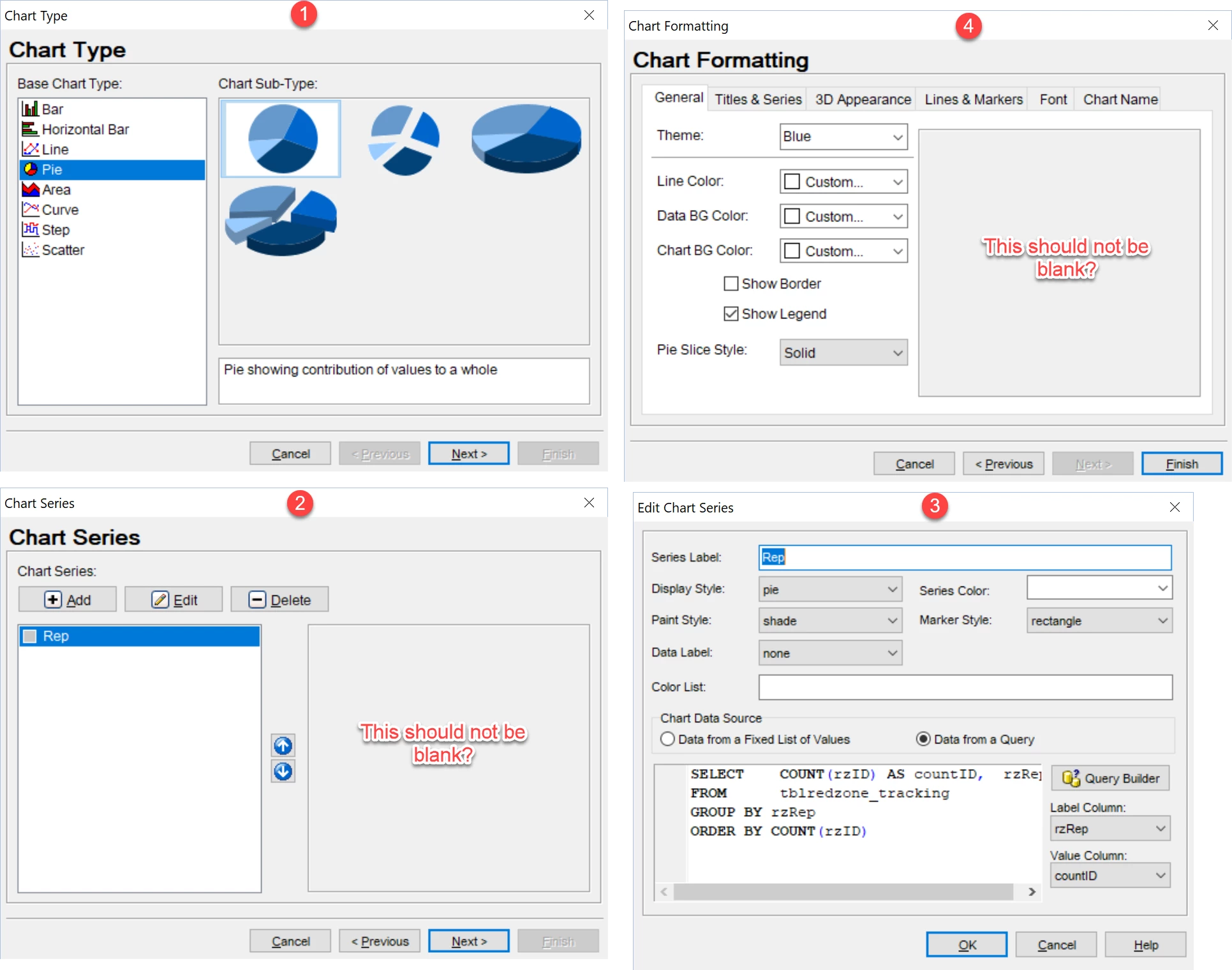

Apr 12, 2018 1:39 PM UTC
I'm having the same issue since migrating to CF2016.. using Colfusion Report Builder 10.282452.
ps: I know that Adobe discontinued CF Report Builder in this release, but shouldn't it still work with the Chart code?
1) When you open up an existing report (.cfr)
2) When you click on chart, the wizard opens fine, you can create your query fine, but two windows are blank?
Is there a way to actually see the charting code that ColdFusion is creating?
