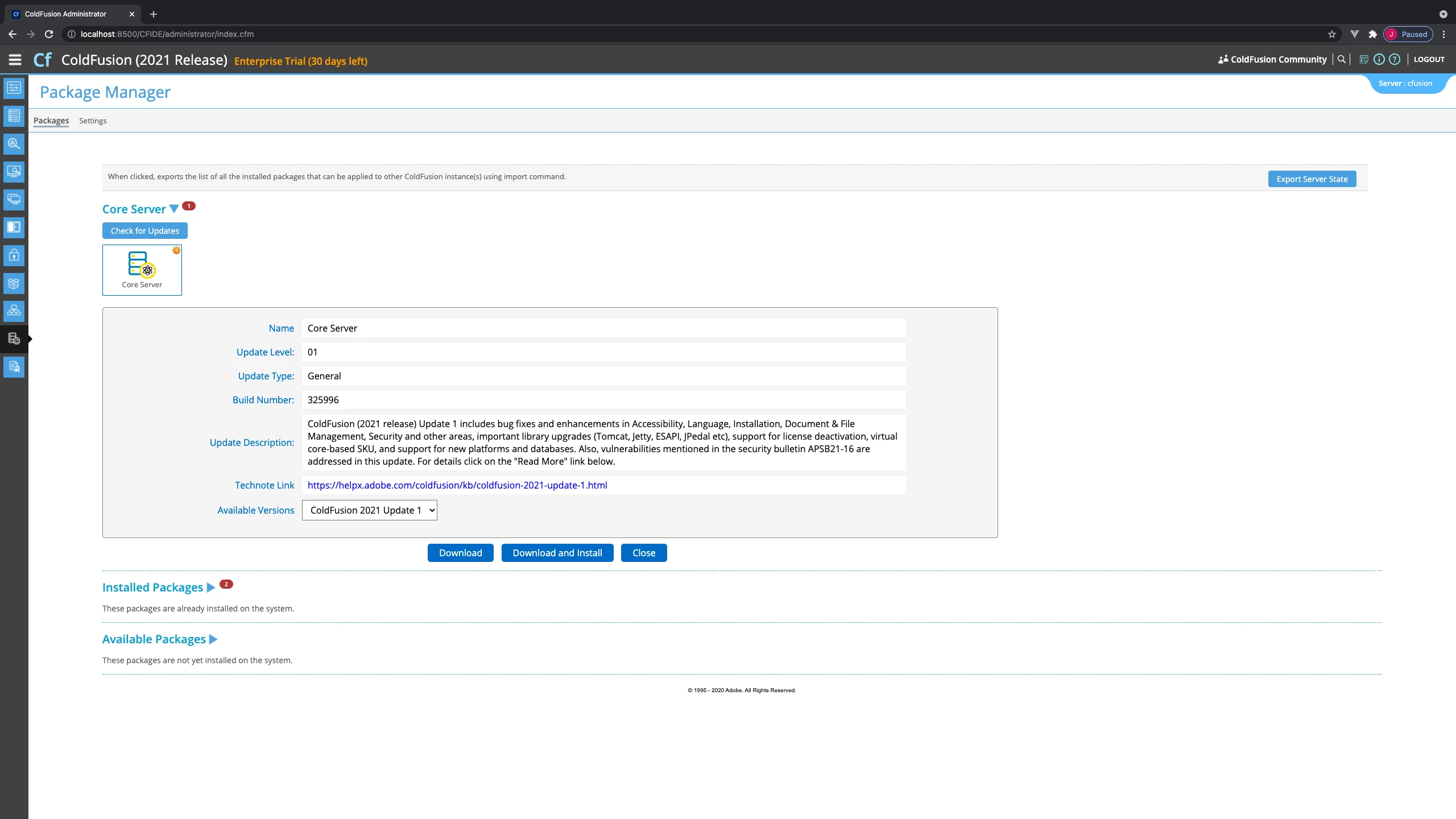

    2.  You could of course just proceed to update the one you have (using the CF admin or by execing into the image and calling the cfpm.sh to do the update), then save that as a new image (using "docker commit"). You could then use that for your needs until Adobe updates their image.

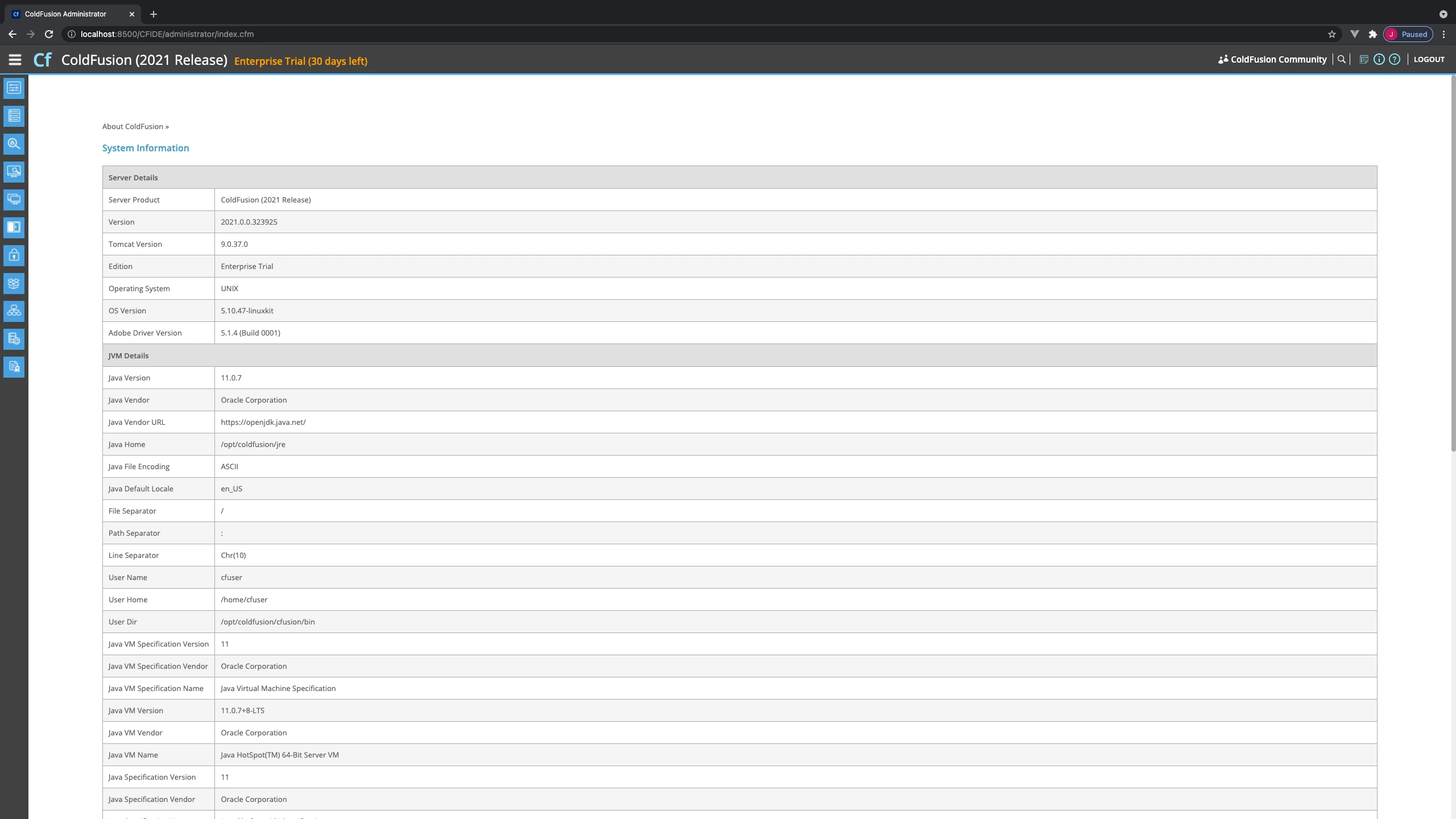

    Aug 26, 2021 4:21 PM UTC
    Realizing that docker run --rm -it public.ecr.aws/adobe/coldfusion:latest info may only return the base version.
    I can confirm Update 1 is not installed when I generate a container using public.ecr.aws/adobe/coldfusion:latest.
