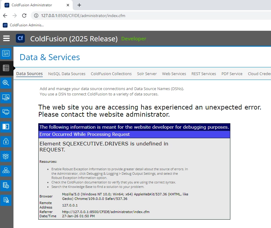

Element SQLEXECUTIVE.DRIVERS is undefined in REQUEST exception in Data Sources tab in Cold Fusion 2025
This happened after I installed all 6 patches for Cold Fusion 2025, in order. I rebooted the system but still got the same error.

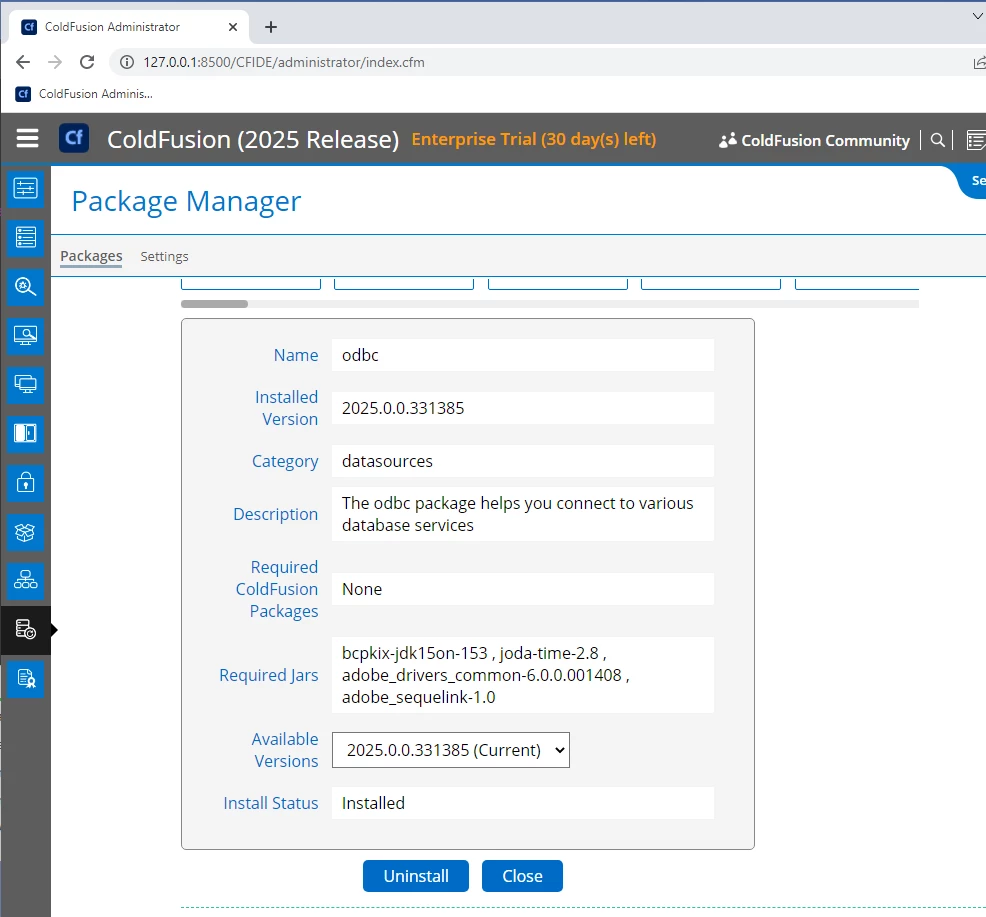

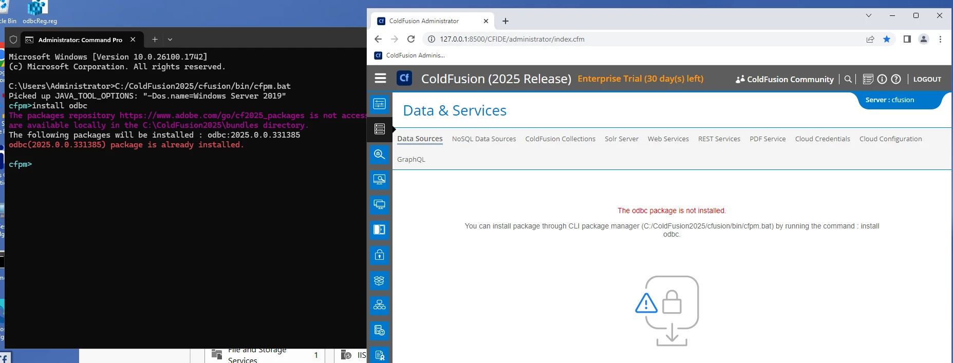

    I’ve gotten past the SQLEXECUTIVE.DRIVERS exception when trying to open the Data Sources tab by updating Windows Server 2025 with all the latest patches. However now I’m getting a new error when trying to add an ODBC connection. Cold Fusion says ODBC isn’t installed but it IS installed, see screenshots.
    Jan 27, 2026 9:28 PM UTC
    Here are all the odbc files in my Cold Fusion directory:
    C:\ColdFusion2025>dir/s/b *odbc*
    C:\ColdFusion2025\bundles\odbcagent-2025.0.0.331385.zip
    C:\ColdFusion2025\bundles\repo\odbcagent-1.0.zip
    C:\ColdFusion2025\cfusion\wwwroot\CFIDE\administrator\datasources\jdbcodbc.cfm
    C:\ColdFusion2025\cfusion\wwwroot\CFIDE\administrator\datasources\odbcsocket.cfm
    C:\ColdFusion2025\cfusion\wwwroot\CFIDE\administrator\setup\odbc.cfm
    C:\ColdFusion2025>
    Jan 27, 2026 8:33 PM UTC
    Here’s the stack trace from exception.log:
    "Error","http-nio-8500-exec-5","01/27/26","15:32:02","","Element SQLEXECUTIVE.DRIVERS is undefined in REQUEST. The specific sequence of files included or processed is: C:\ColdFusion2025\cfusion\wwwroot\CFIDE\administrator\datasources\index.cfm, line: 227"

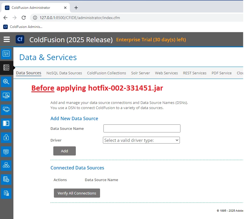

    Jan 27, 2026 8:19 PM UTC
    It looks like hotfix-002-331451.jar is causing the problem. See screenshots.

    Jan 30, 2026 2:17 PM UTC
    ​@johnn82828435  it seems like your packages are not installed properly. Also, can you please check the update is applied successfully.
