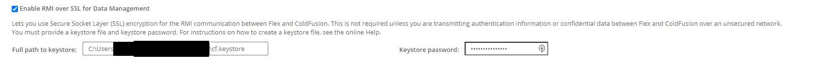

I created a *.keystore file and a *.cer file. I followed this https://usermanual.wiki/adobe/CF11Configen.762142204/html#pf2f/this instruction and tried to add the keystore file to the CF Administrator:

First, you may not need to add any cert. Second, that screen you show is about flex, so not at all what you want to be using.
