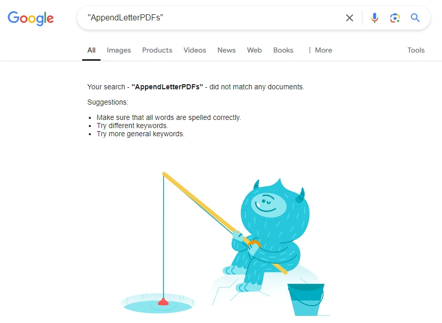

    The cause of issue 2. is obvious. ColdFusion cannot find the class org.util.pdf.AppendLetterPDFs. In fact, neither can Google:
    So, org.util.pdf.AppendLetterPDFs is very likely situated in a custom Jar file.
    Locate the Jar file in your file system. Copy it to cfusion/lib or {YOUR_COLDFUSION_INSTANCE}/lib, making sure that just one version of the fle is available to ColdFusion. Finally, restart ColdFusion.
