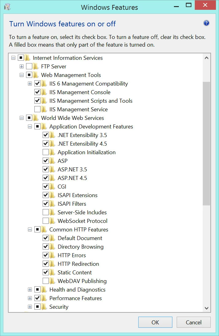

I'm working with a fresh install of Windows 8.1 x64 Enterprise with IIS 8.5. I verified all installed features of IIS as following :
In IIS Management console I verified all access by adding a specific connection user. (the local administrator account)
The default application pool is set to x64 only (= disabled x32 support in Advance settings of Application Pool Management)

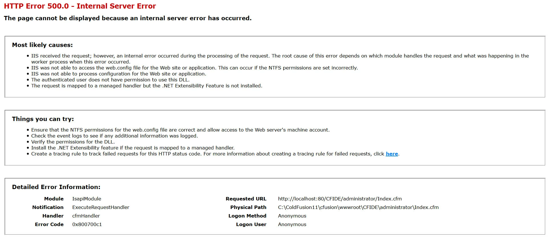

The error message received when browsing the http://localhost/CFIDE/Administrator/ :

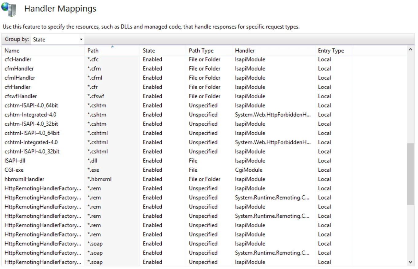

Can you ensure that the cfm handlers are added at the Serevr/Site level?
Anit Kumar
Jun 13, 2014 3:20 PM UTC
Please see Print-screen below:
They appear to be all there...
