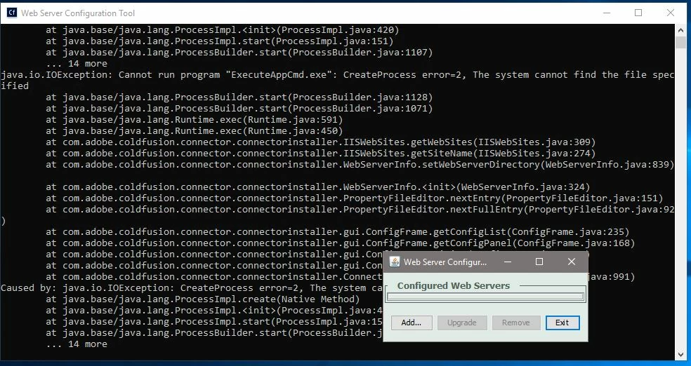

I have 4 seemingly identical servers running Windows Server 2019 and ColdFusion 2018 (on IIS10).  I recently ran through the drill of applying the latest CF updates, starting with Update 4 and then Update 10 (which was cumulative).  On three of the servers, this went fine - after Update 10, I had to run wsconfig and "Upgrade" my connector for IIS, and everything ran fine after that.  But on one server, when I go to run wsconfig after Update 10, I get an error in the DOS-style window that starts with "java.io.IOException: Cannot run program "ExecuteAppCmd.exe": CreateProcess error=2, The system cannot find the file specified", and then a long java trace, and the wsconfig dialog does not list my connector (even though it's there and running).  And if I try to "Add", I get a message saying "All the IIS sites are already configured by some other version of ColdFusion".

Has anybody seen this issue, or have any insight into how to get wsconfig working?  I did look for the ExecuteAppCmd.exe file, and it doesn't exist on the server throwing that error, but does exist in a local temp folder on the ones where it does work.  I don't see any obvious differences in the installed programs on the two servers - both have the three most recent Microsoft C++ redistributables in both x86 and x64.  I need to make sure I have access to wsconfig for upgrading the connectors before I attempt Updates 8-10 again, or know how to manually add the secret to the connector.

Indeed. Make sure that, for the instance in question, the secret in workers.properties is the same as the secret in server.xml. You could then manually upgrade the connector using the Web Server Configuration Tool (wsconfig).
