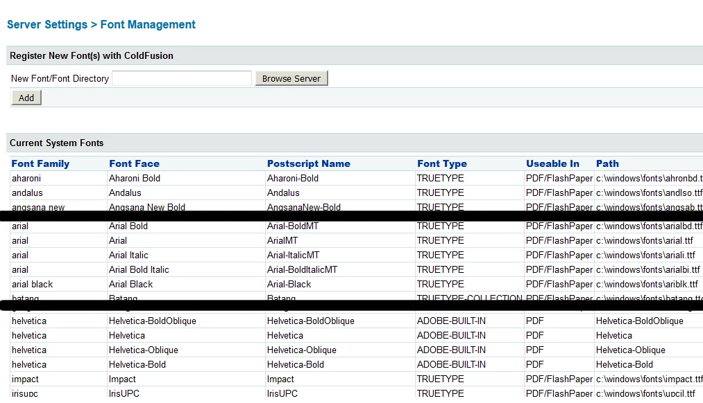

The fonts available, as listed by the ColdFusion Administration page, include ArialMT and Helvetica:
