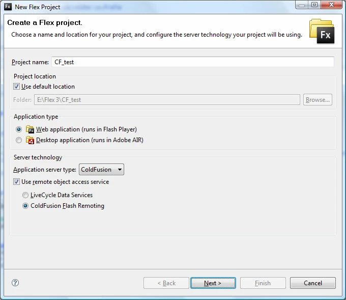

File -> New -> Flex Project
In the "New Flex Project" wizard, fill in a project name.
At the bottom select "ColdFusion" as Application Server Type from the dropdown list.
Enable "Use remote object access service" and select "ColdFusion Flash Remoting".

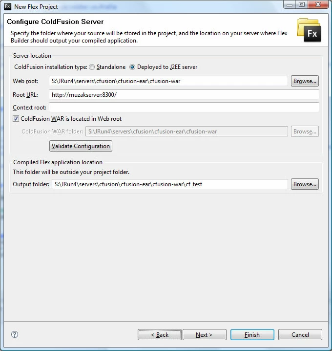

On the next page you have to configure ColdFusion.
For server type, I select "Deployed to J2EE server" as I have CF running on top of JRUN.
The Web root is: S:\JRun4\servers\cfusion\cfusion-ear\cfusion-war
If you don't have a mapped drive you can probably use something like \\SERVERNAME\path_to_root\
Root url: http://muzakserver:8300/
Context Root: leave empty
I have Coldfusion WAR is located in web root selected.

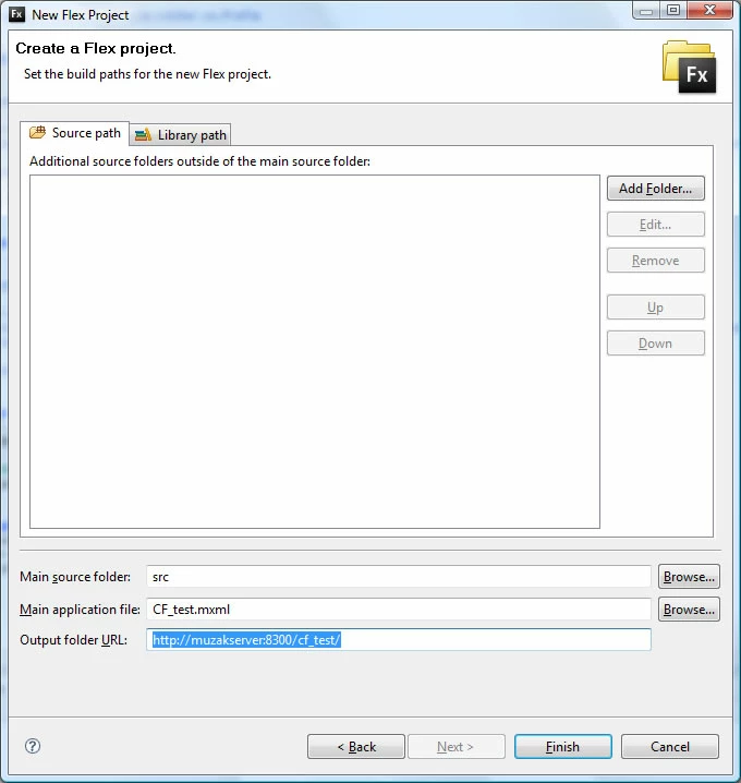

Last thing to do is fill in the url to the application directory on the next page.
At the bottom of the "Source Path" tab, fill in the "Output Folder URL" which in my case is: http://muzakserver:8300/cf_test/

June 29, 2009
Muzak,
First, I didn't want to setup a Samba share, but you do what works.
Second, I can't find "JRun*" or "cfustion-war" on my server.
So, I am still stuck.
Brian
Muzak
June 30, 2009
AFAIK, that's not required.
That's because you have the standalone ColdFusion server installed.
Just adjust the paths I mentioned to whatever your config is.
On the second page in the new project wizard (the server config) select Standalone for the Coldfusion Installation type
Deselect both "Use default location for CF server" and "Use built-in CF server" and fill in (and/or browse to) the proper locations.
