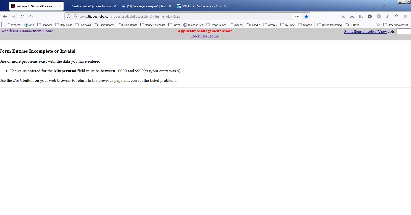

In CF 4.51 the following validation code:
"<INPUT TYPE="hidden" NAME="minPermSal_range" VALUE="MAX=999999;MIN=10000">"
Produced the server side response if your field entry was invalid:
Form Entries Incomplete or Invalid
One or more problems exist with the data you have entered.
The value entered for the Minpermsal field must be between 10000 and 999999 (your entry was 5).
Use the Back button on your web browser to return to the previous page and correct the listed problems.

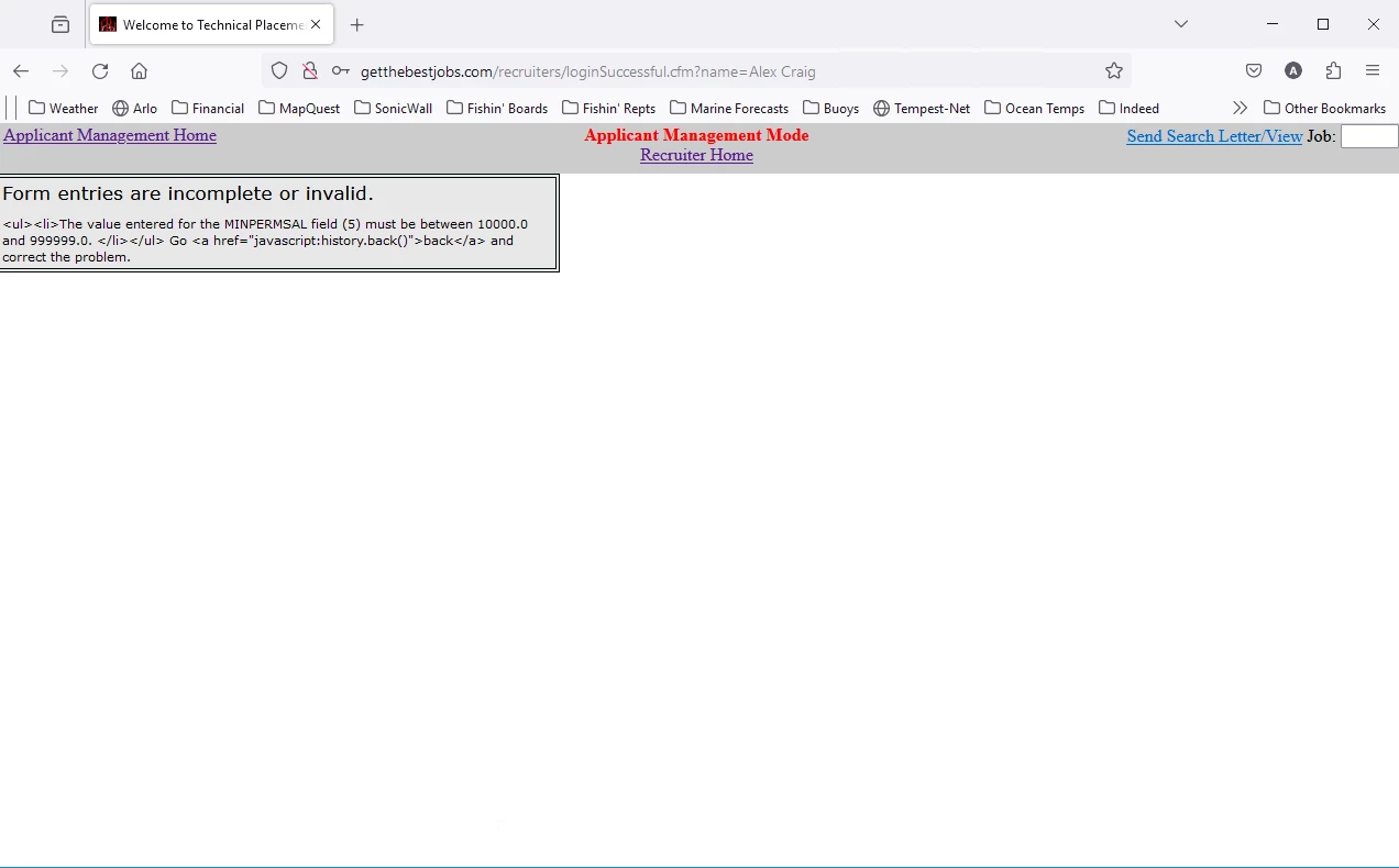

In CF2023 we get:
Form entries are incomplete or invalid.
"<ul><li>The range for the MINPERMSAL field ('5') must have numeric values. </li></ul> Go <a href="javascript&colon;history.back()">back</a> and correct the problem."

I think that the presence of the semi-colon(;) is the cause of the problem.
As @AlexCraig has already shown, replacing the semi-colon with a comma(,) solves the problem. The following (a space in place of the semi-colon) would also work
VALUE="MIN=10000 MAX=999999"

It does not solve the major problem. It only solves the "numeric" reference.
And the latest word from the bug tracker is that the bug has been confirmed & they are continuing to investigate.
A picture is worth a thousand words.  Here are screen shots that illuminate the problem.
As you can see, CF 4.51 renders a user friendly validation screen and CF 2023 using a comma does not.

Got your point, @AlexCraig . There are actually two issues: (1) the display of the HTML as text, and (2) the incorrect response when the delimiter is the semi-colon.
My response was about the second.
