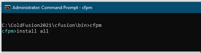

Oct 15, 2023 12:20 PM UTC
quote
Our server is running ColdFusion (2021 Release) Enterprise. Would that release make a difference?
By @ealanjones
Yes, it might. Unlike previous ColdFusion versions, ColdFusion 2021 is modular. This means you can pick which packages to install in CF2021. So, it just might be that a package that your application needs was left out during installation.
To check out that idea, here is a suggestion:
  • (Assuming you are on Windows) Open the Command Prompt (cmd) as Administrator;
  • Use the DOS cd command to navigate to  {CF2021_HOME_DIR}/cfusion/bin;
  • Type cfpm and press ENTER. You should get ColdFusion's package manager prompt cfpm;
  • Run the command install all
  • Keep running the command install all till the result is either an error or ColdFusion tells you that "All the packages are already installed".
  • If the former, then share the error message with the forum. If the later, then restart ColdFusion in the usual way, and see if that solves the problem.
ealanjones
Oct 16, 2023 1:46 PM UTC
Well, I tried the above... Now CF and SQL aren't speaking. I can't establish a connection between the two and they are even on the same server.
Please advise.
