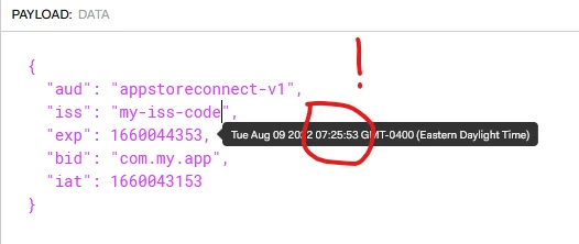

    But then I noticed something when I tried pasting my token to jwt.io:
    The time portion of my Epoch code was 4 hours ago!  So, the expiration had long passed!  WTF?
    SOLUTION:
    So, I removed my epochtime() function and, instead, made a simple change in the jwt.cfc script using the int() function to make sure the converted time is an INT:
