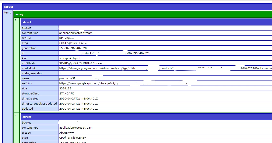

So I am trying to convert my JSON into a cfquery object to use it in my application.
Here is what my JSON looks like. Its a structure containing an array of structures.

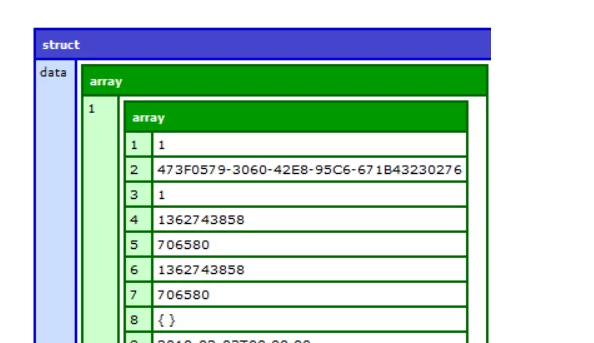

But when I look at other CF posts on this topic I see the JSON data looks like this.
A Structure of Arrays. Which there is a lot of documentation on how to work within cf.
QUESTION: How do I get my deserialized JSON file to be a Structure of Arrays instead of a structure containing an array of structures

    May 6, 2020 2:04 PM UTC
    It depends upon how it was created.
    If the JSON object was created from a CF query object, and if a certain flag was set to 'true', then it's just a matter of deserializing it back into a query object.
    If, however, it was not done with the true flag, or if it was created from a source other than CF (like a third-party API), then check the stringified format of the JSON object and compare it to the stringified format of a JSON object created by CF with the true flag set, and manually edit the other one to match.  Then you could convert it back into a query object.
    I know that's not exactly the answer you were looking for, but just something to consider.
    V/r,
    ^ _ ^
    weezerboyAuthor
    May 6, 2020 3:07 PM UTC
    Thank you, Wolf. This JSON was created by a Google API. I'll try what you suggest. Any idea where I can get a stringified format of a JSON object created by CF with the true flag set?
