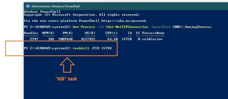

      Take, for example, my debugging port, 5005. I am on Windows. To identify the process running on port 5005, I open Windows PowerShell as Administrator, and run the following command
      Get-Process -Id (Get-NetTCPConnection -LocalPort 5005).OwningProcess​
      The result is:
      Note that the result includes the ProcessName and ID. I am happy with process 15728.
      But let's suppose, on the contrary, that a process with that ID (15728) was in the way of my debugging. Then I could "kill" it.
      To do so, I would just have to run the following command within the same PowerShell window:
       taskkill /PID 15728
