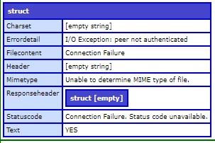

The call works fine about 75% of the time, but for the other 25%, this comes back:
The same POST through the Postman app never results in this error.

First, about the sporadic nature, I suspect that is not about cf, but rather is likely caused by the fact that the remote site you're  calling has a load balancer, such that calls go to multiple web servers that are not identically configured, and something about one (or more) is configured such that the cfhttp call fails.
As for what you need to do, it MAY involve importing certificates, but instead it more likely is simply a need to update the jvm that cf uses.. I discuss that in a post:
https://coldfusion.adobe.com/2019/06/error-calling-cf-via-https-solved-updating-jvm/
You'll see I quote there the very error you indicate. And yes, I discuss how a jvm update is easily reverted if done correctly, with more detail in another post I point to there.

Great to hear that you may have solved it, rimshot, with that JVM update. (Your reply confirming that is nested within a set of replies, so I thought I would draw the point out here, to make it easier for future readers to see that the problem was solved--or at least, you're waiting to confirm over time if it is so. And if it is, I hope you will mark as "the answer" the first comment where I indicated that.)
BTW, you mention you moved to Java 12. I would not recommend that. I explain why in another blog post (which I link to from the one I pointed to in my first reply). It would be in your interest to see if instead Java 11.0.7 (the latest current Java 11 update) would work. As I explain in the post, Oracle no longer supports Java 12 (or 13 or 14), but they do still support Java 11. See the post for more. The point is, you don't want to be running a Java version that Oracle no longer supports.

There are indeed explanations and solutions for that challenge, rimshot,
And easily reverted if needed.

I called the same URL numerous times using Postman from the same machine running CF, and never got the "Connection Failure" message. Wouldn't a load balancer issue equally affect calls from both CF and Postman?
July 8, 2020
No, Postman doesn't use the same keystore as your JVM. In general, browsers have much larger keystores than JVMs do. So it's likely that Postman (or Chrome, or your OS, wherever Postman is getting its stored certs) has root and intermediate certs for both servers behind the load balancer.
And that's where I think your problem is. When you purchase a cert, you get not just that cert itself, but the root and intermediate certs upon which the individual server cert relies. For example, when you go to www.google.com, your browser receives that certificate for www.google.com and finds out whether it has a certificate of its own that says www.google.com is a valid certified name that corresponds to Google, Inc. This may involve one or more additional certificates. In Google's case, there's an intermediate certificate from "GTS CA 1O1" that says your browser should trust www.google.com. But that certificate itself isn't trusted! So, your browser looks for a certificate that says "trust GTS CA 1O1", and finds a root certificate from "Google Trust Services - GlobalSign Root CA". As far as I know - and I could be wrong about this but am too lazy to look - your browser only really needs to have the root certificate, and it'll then go out and get the intermediate cert as well as the server cert. (I do know that your JVM doesn't actually need the server cert when it's doing this, but it does need the server and intermediate certs.)
So, back to your problem. Let's say that server A got its certificate at one time, and server B got its certificate at a different time. It's possible for them to have different root and/or intermediate certs. So your JVM would trust one server cert but not the other.
Dave Watts, Eidolon LLC

Thanks. I will definitely try the certificate key store steps in whatever priority order the responses here indicate might be best. If a cert is missing in the store, though, I can't help but wonder why ity would work some of the time.
BKBK
July 8, 2020
Rimshot: "If a cert is missing in the store, though, I can't help but wonder why ity would work some of the time."
Then Charlie_Arehart's will be a more likely explanation. The Webmaster or Server Admin could provide you all the certificates you need.
