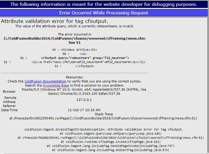

Just recently I started this tutorial for CFML. Going through this course was pretty straightforward and almost without a hassle. But now I have hit a brick wall at using coldfusion components. I followed the instructions in the video and the assignment but I stumble upon this error and cant figure out what is going wrong.
As I am adding the references to the different functions in the component i stumble upon an error. The reference to the getNewsYears function is at the top of my code(as the assignments says). But the output is somewhere at the bottom. The Error below keeps popping up.
I cannot find any info on frequent mistakes made during the tutorial. Can anybody see what I am doing wrong?
    Oct 11, 2017 11:00 AM UTC
    Hahaha that did the trick. I dont know how I missed it. Thanks a bunch!
    Oct 11, 2017 9:18 AM UTC
    This seems like a spelling mistake. You will need to show your code though so we can see.
    This normally means the rsNewsYears does not exists. Check the name you gave the query further up the code.
    Oct 11, 2017 9:50 AM UTC
    Hi thanks for your reaction! I tried looking for spelling errors but didnt find anything.
    This is the news.cfm code

    Oct 11, 2017 10:01 AM UTC
    The only place you have defined this before is further up but its a different spelling - rsNewYears is not rsNewsYears as you are using on the error line
