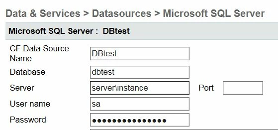

    Hi Prushka,
    Is SQL 2005 running as an instance?
    If so you might like to try connecting to it like pictured removing the port number details.
    HTH, Carl.
