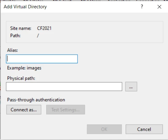

    This was removed as part of CF2016 release. We can still configure the CF Admin from webserver the way you used to have in old CF server.
    Launch IIS Manager>Select Site and right click>Select Add virtual directory and click Ok
    Alias as "CFIDE"
    Physical Path = \ColdFusion2021\cfusion\wwwroot\CFIDE    // Select Directory based on the driver it is installed.
    Go to ColdFusion2021\config\wsconfig\{magic folder}.
    Take the backup of uriworkermap.properties. Open this file and uncomment CFIDE by removing the "!". Save the file and restart IIS.
    Then try to access using https://My.Site.org/CFIDE/administrator/index.cfm
    Hope this helps.
    Alias as "CFIDE"
    Hope this helps.
    Thanks, Priyank Shrivastava

    Fantastic!  Thank you!
    I did need to restart the CF Server.
