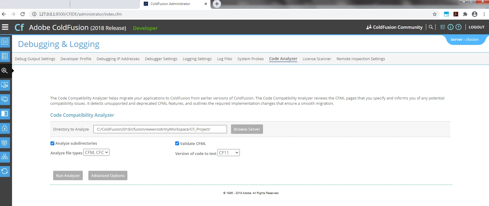

    First, let's be clear that each ColdFusion version comes with its own Java version. As for the CFML code, you should take it that ColdFusion 2018 is backward-compatible. Not only to ColdFusion 11, but to earlier ColdFusion versions. You don't need documentation for that. You can take it as information from this forum. In fact backward-compatibility is one of ColdFusion's strongest selling-points.
    Anyway, ColdFusion doesn't leave it to chance. It includes Code Analyzer, a tool you can use to check whether code is backward-compatible. You will find it in the Debugging section in the ColdFusion Administrator:
