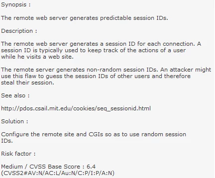

@BKBK I need it to resolve a Nessus Finding.  Web Server Uses Non Random Session IDs, Nessus ID 31,657.

There may be nothing for you to worry about. Nessus probably based its conclusion on just the CFID identifier, which is sequential. However, Coldfusion's session ID is random, as you would have found out when you followed the link in your original post.
The other Coldfusion session identifier, CFToken, is random. Hence, the session ID, which is the combination of CFID and CFToken, is random. Sequential + random = random.
